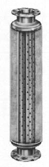

Several simple techniques can attenuate noise at the compressor. Install a muffler or silencer on the inlet (Figure 3). Device selection must consider its effect on compressor operation, available space and noise characteristics.
Treat high-frequency inlet noise with a simple absorptive muffler. These have a straight perforated pipe through a housing stuffed with fibrous media. You might have used a similar “glass-pack” muffler on your car to achieve that muscle car sound.
The absorptive muffler has a low-pressure drop and can be used at an open inlet unit with a filter or in-line if low-pressure air is being piped from a remote source. Some combination filter-silencer products may be available from filter manufacturers.

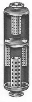

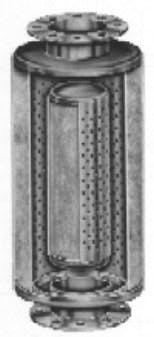

Figure 3. Pick a muffler
Use absorptive mufflers (left two) for high-frequency noise. Consider expansionchamber or reactive mufflers (right two) for low frequencies. Low-frequency inlet noise can be treated with an expansion chamber muffler, but at the expense of much greater pressure drop. The expansion chamber, or reactive muffler, is a housing with two or more empty chambers connected by short segments of perforated tube, similar in design to the standard auto muffler.
Centrifugal compressor discharge and inlet noise may be treated similarly, but positive displacement compressors require pulsation control. In either case, an inline silencer and a pulsation damper (similar to a two-chamber reactive muffler) can be installed in the discharge piping.
