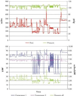

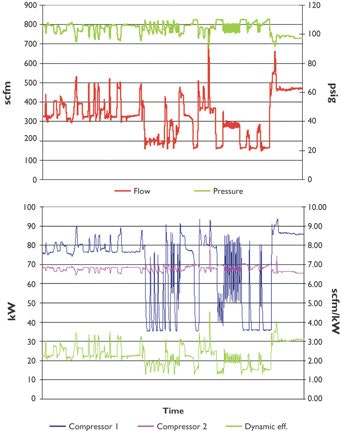

Figure 2. Demand profiling should include the four primary elements affecting performance: flow, pressure, time and power.
The real-time ratio of flow and power (scfm per kW) is a responsible benchmark for performance. Motor, bearing and lubrication enhancements are improving reliability at high speeds. "In the past 10 years, most of the development has gone into motors," says Mahesh Joshi, director, global marketing, Ingersol-Rand (www.ingersol-rand.com). "Now, what was high-speed is daily life. With better bearings and prime movers, reliability is up and costs are generally lower. And even when the compressors are more expensive, the life cycle cost is better."
