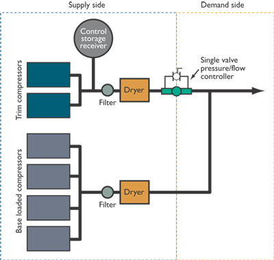

Pressure/flow controllers are precision control valves that vary the airflow to maintain discharge pressure within approximately one percent of setpoint without introducing additional pressure loss. Multi-valve pressure/flow controllers are also available for systems with critical redundancy requirements or unusually large variations in compressed air demand.
Figure 2 shows a typical system using a pressure/flow controller. Normally, only one of two trim compressors operates upstream of the pressure/flow controller, which minimizes the energy consumed. The remaining compressors operate downstream of the pressure/flow controller at a pressure equal to the header pressure plus the differential across the filter and dryer. Operating at this lower pressure reduces power to these base-loaded compressors by 10 to 20%, depending on individual pressure requirements.
Figure 2. A typical system using a pressure/flow controller.
Eliminate system dynamics
Variations in system demand, compressor operating mode, setpoints and pressure drops across cleanup equipment cause pressure swings. Pressure/flow controllers eliminate pressure swings by separating the air supply from the air demand, which stabilizes header pressure.
The pressure differential produced by reducing the pressure in the distribution header is useful storage that supports intermittent demand events without starting another compressor or affecting header pressure.

To maintain a constant system pressure, the pressure/flow controller requires sufficient upstream and downstream storage. The three common types of compressed air storage are summarized below:
Control storage: Upstream or control storage is a form of potential energy that the pressure/flow controller releases to maintain header pressure. Proper control storage volume depends on the trim compressor's capacity and operating mode, the magnitude of the largest event (normally the failure of the largest compressor), and intermittent, coincidental events.
For example, the part-load efficiency of many rotary screw compressor operating modes relates directly to the amount of system storage. In addition, compressor manufacturers impose a minimum load/unload cycle time to prevent mechanical failure. For compressors operating in load/unload mode, a good guideline is a minimum of 10 gallons of storage for every cfm of capacity in the largest trim compressor. Assuming a 10-psi control band, using this approach to size the control storage provides reasonable compressor efficiency and a minimum load/unload cycle time of four minutes. Additionally, the control storage should have the capacity, within the available differential, to support the system through the largest event (normally the failure of the largest compressor) without loss of header pressure. In systems with large events, this may require supplementing the control storage with high-pressure offline storage.
General storage: Downstream, also called general or header storage, controls the rate of pressure change in the distribution header, which gives the pressure/flow controller and trim compressors time to respond to an event. To be effective, general storage must be located strategically so that high flow rate applications can access it during each cycle. Otherwise, the event will draw down the volume in the header, producing unacceptable pressure variations.
Secondary storage: Secondary storage is dedicated storage, with or without metered recovery, that's located at an end-user. While secondary storage isn't required for a pressure/flow controller to function properly, its use reduces critical pressures, which allows plant personnel to reduce header pressure and save energy. For example, installing secondary storage at baghouses and dust collectors allows them to operate at 80 psi instead of 100 psi or more.

Exceeding a pressure/flow controller's maximum capacity introduces a pressure drop that consumes useful storage differential pressure. Using an oversized unit, on the other hand, results in header pressure variations at minimum airflow. To size a pressure/flow controller properly, you'll need the following information:
Minimum, normal and maximum airflow.
Inlet temperature.
Maximum and minimum setpoint pressure.
Maximum and minimum upstream pressure.
