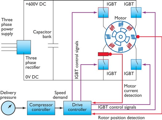

The switched reluctance (SR) drive (see Figure 1) suits the needs of rotary screw compressors. It follows the variable-speed route, but not by using a frequency inverter or an ac induction motor. The drive uses high-current transistors controlled by a microprocessor to switch on a dc supply to the SR motor stator windings.
The switched reluctance, two-phase dc motor is driven by switching current between the A phase and B phase stator windings. The phases are connected to two sets of four stator windings. In the broadest sense, repetitive switching of current to the windings produces a magnetic field, causing the steel-laminated rotor to rotate. The available motor torque regulates motor speed, which, in turn, is controlled by the current applied to the windings. The current is controlled by the motor's drive electronics via the switching transistors, which limit the current by adjusting the time the windings are energized (see Figure 2). The microprocessor's absolute control over the on/off switching of current going to the motor's windings achieves maximum energy transfer.

Figure 2. Switched reluctance drive system with two pairs of transistors (IGBT) that are switched on/off to provide current pulses to the drive motor.
