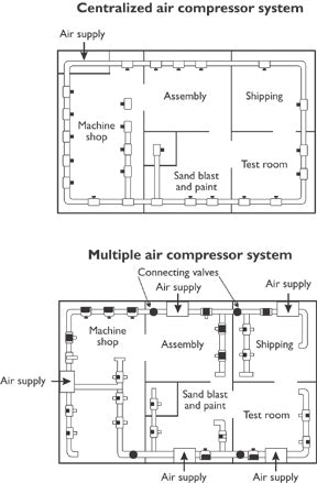

While the primary responsibility for specifying a new or expanded compressed air system usually rests with the plant engineer, others may be involved in the decision-making process. A specifier has two options: a plant-wide centralized compressed air system or a distributed system using multiple localized compressors (see Figure 1).
Figure 1. Heat from a compressor can be recovered and used for space heating, thus reducing utility costs.

Figure 2. Piping layouts are similar for multiple and centralized systems. Connecting valves allow multiple systems to back up each other.

Central systems usually involve several large compressors at a single location in the plant. In this arrangement, a primary compressor is kept online to meet base load, while a running, unloaded standby compressor meets fluctuating demand. Reserve capacity provides a built-in safety factor in case of primary compressor failure. If properly sized, the secondary compressor permits primary unit maintenance with no interruption in air supply.
A multi-compressor system can, with proper controls and interconnecting hardware, perform as a centralized system to handle a variety of load fluctuations.
