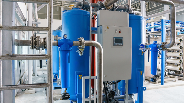

The range of Cerades solid desiccant air dryers from Atlas Copco now includes smaller CD+ dryer sizes. The patented Cerades structured desiccant has several advantages over standard commercially available desiccant beads, according to Dryer Media Taskforce Leader Chiara De Timmerman. For one, it reduces the pressure drop in the air flow, resulting in dry compressed air delivery at PDP -40 °C with improved energy efficiency.
“Secondly, the solid structure of Cerades allows significant dryer size reduction and freedom of orientation during installation (vertical or horizontal). Additionally, there are important health and environmental benefits; because this material does not decay in time, no dust is released into the atmosphere,” adds De Timmerman.
