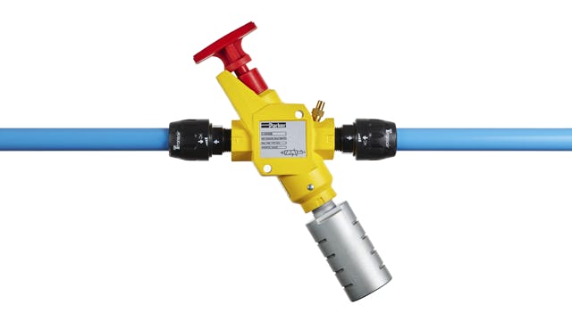

The purpose of a lockout valve is to quickly expel the pressurized compressed air in the lines and shut off the machine. This is done for maintenance and in emergency situations. When the handle of the lockout valve is pushed inward, it shuts off the flow of compressed air, and vents the downstream pressure out the exhaust port. Once the handle has been pushed in, a lock can be placed on the handle, preventing the handle from being pulled out and resuming the flow of compressed air to the machine prematurely. Unlike a ball valve that can be locked in both the open and closed positions, lockout valves can only be locked when the handle is pushed in, cutting off the flow of compressed air.
2. Can they be easily identified as an isolation device?
In the unfortunate event that an emergency shut-off is required, no one wants to be fumbling around trying to find what valve will shut off the flow of compressed air. To meet this criteria, most lockout valves are painted a bright yellow color and have a red handle (see Figure 1), making them easy to identify as a compressed air line shut-off.
