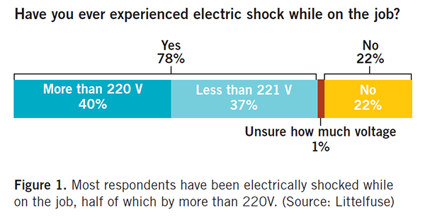

Finding #1: A shocking paradox – Confidence in ability to recognize an electrical hazard and a history of being shocked. Nearly 40% of the respondents said they have been shocked by more than 220V while on the job, which was about half (51%) of the 78% who reported having experienced electrical shock at any voltage (see Figure 1).
Most (85%) of the respondents who reported having experienced more than a 220V shock also rated themselves as either “very confident” or “extremely confident” when they were asked to rate their ability to recognize an electrical hazard. This was significantly more than those who have never been shocked when on the job and slightly higher than those who reported having experienced shock from less than 220V (82%) (see Figure 2). Overconfidence was also frequently cited among respondents as the main reason why people at their facility work on live equipment.
