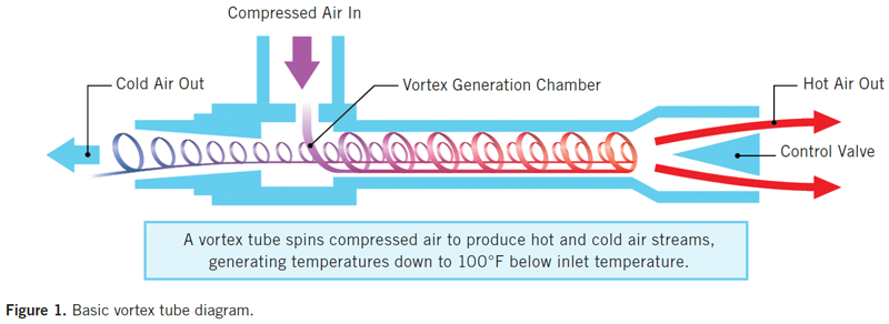

  • Vortex systems: Though compressed air can be costly, vortex cooling is an effective, safe, and low maintenance way to cool enclosures. Vortex tube technology converts compressed air into cold air without the use of electricity or coolants, and can reduce the temperature of the compressed air by 50°F (28°C) or more (see Figure 1). This means that enclosures are supplied with cold, slightly pressurized air, while oil and dust are also prevented from entering the cabinet. Vortex cooling systems have no moving parts, so they require very little maintenance, apart from occasionally changing a filter element, which ensures that clean, dry air enters the enclosure.
