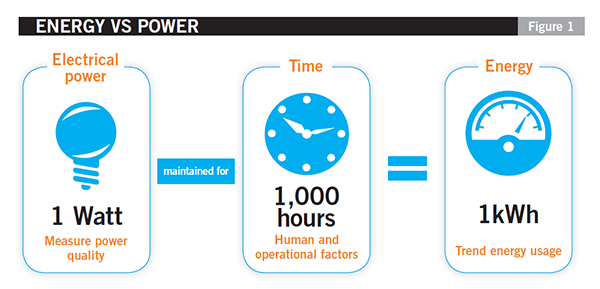

What's the difference between energy and power?
The words “energy” and “power” often are used interchangeably; however, it’s not accurate to do so. To be exact, one watt of electrical power maintained for a thousand hours equals one kilowatt hour of energy (see Figure 1). Put another way, energy is the capacity to do work, whereas power is the rate at which work is done.
Usually when you measure power, it’s to measure quality, and factors such as time, human behaviors, and operations can have an impact on power quality. Examples:
Human factors – how long are lights being left on; are windows and doors being left open, letting hot air in or cool air out?
Operational factors – how fast am I pumping this liquid; how much air needs to go through the air handler?
When we talk about energy, we’re talking about the capacity to do work. In physics terms, energy is what makes it possible to move objects. Whether moving an electron down a wire or a car down the road, work is being done. If you know the strength of force needed to move the object and you know how far it will move, then you can calculate the energy needed. When you measure energy, you typically track it as well as trend it – building a repository of valuable historical data in the process. You can do the same with power; you can track and trend it.
