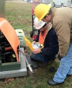

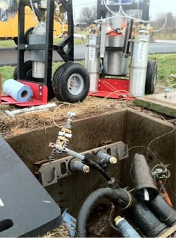

Cable rehabilitation specialist Novinium developed the hybrid injection process that Empire chose for its rejuvenation project. Hybrid injection incorporates both low-pressure improved unsustained pressure rejuvenation (iUPR) and higher-speed sustained pressure rejuvenation (SPR) to give work crews the flexibility to choose a rejuvenation method based upon the characteristics of a particular cable segment.
Unsustained pressure rejuvenation has been around for more than 20 years; the “improved” part of iUPR, so named by Novinium, reflects the incorporation of newer, more-durable seals that lower the risk of injection fluid leaks (leaked fluid compromises injected cables’ reliability) and the use of proprietary reticular flash-prevention technology that reduces the chance for injection port flashover.
iUPR is slower than SPR is, typically requiring 12–24 hours for completion of the injection process and 18 months for the injection fluid to fully permeate cable insulation and return that cable to full strength. But the lower pressure means that fluid can flow safely through existing cable splices. Because no splice removal is required, iUPR can be an attractive choice for projects in which it would be difficult to access splices and/or cost-prohibitive to replace them. (Airflow and pressure tests are performed to make sure a given cable segment and splices are suitable for injection, Novinium notes.) The iUPR injection process typically cuts power from a cable segment for about 30 minutes.
SPR holds appeal for large injection processes because of its speed. A 300-foot segment takes around 30 minutes to complete, meaning that injection for an average-size project can be finished in a couple of hours. Injected cables will reach their full dielectric strength in a week.
With SPR, after splices are detected using a radio frequency locator and a measuring wheel, pits are dug and the splices are removed. A radial press is used to install injection adapters and a splice connector. Once the fluid is injected, injection equipment is removed, splice installation is completed and standard elbows are installed at each end.
