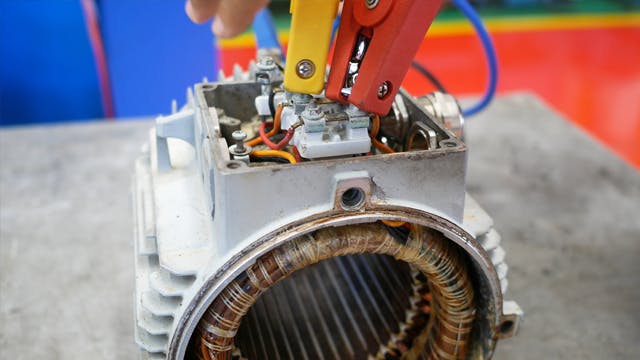

This article describes the insulation resistance testing method commonly used for preventive maintenance activities. Insulation resistance testing is commonly performed as part of electrical testing in a preventive maintenance program for rotating machines, cables, switches, transformers, and electrical machinery where insulating integrity is needed. Insulation resistance testing in the preventive maintenance program helps identify potential electrical issues to reduce unpredictable, premature equipment repair and replacement cost (see Figure 1).
Insulation resistance is used to verify the integrity of the insulation material, whether cable insulation or motor/generator winding insulation. Insulation resistance testing is carried out by applying a constant voltage to the equipment under test while measuring the flowing current. High DC voltage is used, causing a small current to flow through the insulator surface. The total current consists of three components (see Figure 2):

As insulation resistance testing involves high DC voltage application, the following safety precautions should be taken:
  • Make sure that the device under test is discharged.
  • Conduct the test at the de-energized condition to ensure that no test voltage other than that from the insulation resistance tester is applied.
  • Restrict personal access when high voltage testing is being conducted.
  • Use of personal protective equipment (e.g. protective gloves) where applicable.
  • Ensure suitable test leads are used and that they are in good condition. Using unsuitable test leads not only contributes to errors in readings, they may be hazardous.
After the test, make sure the device is fully discharged. This can be done by shorting the terminal with a suitable resistor. A minimum discharge time of four times the applied voltage duration is recommended. Some insulation resistance testers may have the built in self discharge circuit to ensure a safe discharge after the test. Testers with this feature ensure devices are safely discharged after every test.
