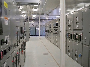

Figure 1. The electric power generation, transmission, and distribution sector, commonly called utility companies, has long been considered so technically unique and self-regulating that further intervention was not necessary or already was being addressed internally.
