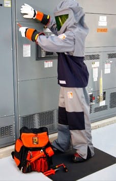

Figure 1. With the current focus on arc flash safety and the availability of means to upgrade equipment, the path to safety and improved reliability is easier to navigate. (Source: Fluke)
With the current focus on arc flash safety and the availability of means to upgrade obsolete and poorly maintained equipment, the path to safety and improved reliability is easier to navigate, but the first step is to be aware of the implications of poor maintenance and make a decision to improve it (Figure 1).

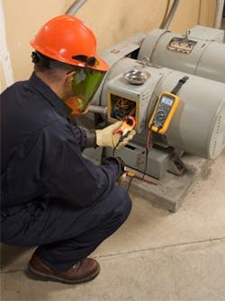

Figure 3. Failures are usually the result of normal aging of components, which is exacerbated by failure to perform required regular maintenance and testing. (Source: Fluke)
Electrical power and control equipment can be thought of as having two types of components — passive components and active components. Passive components are such things as equipment steel enclosures and structural framing, busbars, cables, and insulators. Active components are the circuit protective devices such as circuit breakers, protective relays, and fusible devices, as well as some metering devices.

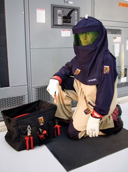

Figure 4. Maintenance requirements for electrical equipment will vary, depending on factors such as the operating environment, duty cycle, and the type of equipment and its voltage class. (Source: Salisbury by Honeywell)
Maintenance requirements for electrical equipment will vary, depending on factors such as the operating environment, duty cycle, and the type of equipment and its voltage class (Figure 4). Small molded-case circuit breakers, for example, require almost no maintenance. Their internal mechanisms are designed to be relatively maintenance-free over their designed service lives. Maintenance requirements for these devices are limited to operating the breaker on and off two or three times annually. This is called “exercising the breaker,” which helps to distribute lubrication in its pivot/bearing points and wipes the pole contacts to keep them clean. Circuit breaker plastic cases should be examined periodically to ensure the cases aren’t damaged or cracked. Cable lugs should be checked to ensure they’re tightened to factory specifications. Periodic infrared inspections are a good way to easily identify any loose cable lug terminations.
