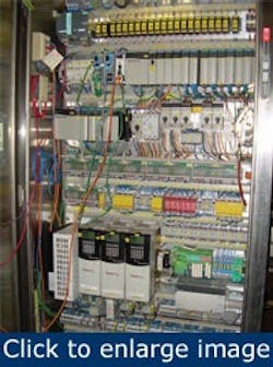

Figure 1. This automation cabinet contains power, control, and communication wiring. A 480-V disconnect handle is at the upper right of the cabinet. PLCs near the top of the cabinet use 24-V inputs and outputs to control a conveyor system while 480-V VFDs near the cabinet bottom drive the conveyor motors.
It’s generally best to stand to the side of the cabinet, if possible, to operate disconnects, release latches, and open doors, just in case something goes wrong. Once the cabinet door is open, make a visual inspection for obvious abnormalities and the smell of burnt insulation (Figure 1). Refer to the appropriate wiring and control circuit diagrams to identify components and terminal strips.
