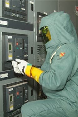

Figure 1. The incident energy potential will define the hazard/risk category of personal protective equipment that an employee is required to wear.
Conduct an electrical system study to determine the degree of arc flash hazard. This is an electrical system engineering study that is performed by engineers familiar with the power distribution and control equipment and the calculation methods required. The arc flash analysis will determine, among other things, the incident energy potential of each piece of electrical distribution equipment in the facility. This incident energy potential will define the hazard/risk category of personal protective equipment (PPE) that the employee is required to wear while performing any work when energized parts are exposed (Figure 1). The methodology for conducting these arc flash analyses is outlined in IEEE 1584 Guide for Performing Arc-Flash Hazard Calculations.

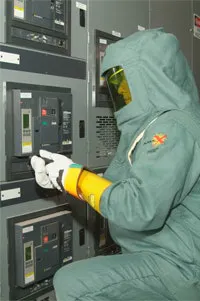

Figure 2. Electrical distribution systems contain active components such as circuit breakers that help protect the system in the event an electrical fault occurs.
Maintain all electrical distribution system components. All electrical distribution systems contain active components such as fuses, circuit breakers, and protective relays that help protect the system in the event an electrical fault occurs (Figure 2). These components, called over-current protective devices, have a critical role in protecting the system, but are also crucial when it comes to protecting workers from the hazards of arc flash and arc blast. Modern, properly adjusted over-current protective devices that have been well maintained are able to detect an arcing condition almost instantaneously and clear the fault quickly. This always results in significantly reducing the amount of incident energy that is released.
Many existing electrical distribution systems have old components that have not been well maintained over long periods of time. In actual field testing of these devices, it is often apparent that their ability to react to an arcing event is much slower than would be the case with a modern, well-maintained device. Unless the protective device optimally reduces the time to clear the fault, the hazard to a worker standing within the flash protection boundary can dramatically increase. In the past, attention to maintenance and condition of these devices in many facilities has not been a primary concern for most facility owners, as in many cases it was not clearly understood that poor condition or inadequate maintenance of the devices presents an elevated safety hazard for workers.
