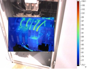

The most valuable tool for evaluating capacitor banks is a thermal imager (Figure 1). The electrical distribution system should be operating for at least an hour before testing. To begin, check the controller display to determine if all the stages are connected. Next, verify that the cooling fans are operating properly. Conduct an infrared examination of the enclosure before opening the doors. And, based on your arc-flash assessment, wear the required personal protective equipment.
Figure 1. A thermal examination would have detected abnormal heating, and damage to a circuit breaker feeding a capacitor bank might have been avoided.
Examine the power and control wiring with the thermal imager, looking for loose connections. A thermal evaluation can identify a bad connection by showing a temperature increase caused by the additional resistance at the point of connection. A good connection should measure no more than 20 °F above the ambient temperature. There should be little or no difference in phase-to-phase or bank-to-bank temperatures at points of connection.
Figure 2. The difference in temperature indicates that the fuse on the left is blown.
An infrared evaluation can detect a blown fuse by highlighting a temperature difference between blown and intact fuses (Figure 2). A blown fuse in a capacitor bank stage reduces the amount of correction available. Not all correction units are equipped with blown-fuse indicators. If you find a blown fuse, shut down the entire bank and determine what caused the fuse to blow. Some common causes are bad capacitors, reactor problems and bad connections at line-fuse connections, load fuse connections or fuse clips.
Figure 3. An infrared image can show that a capacitor is cooler, indicating it has failed.
Look for differences in the temperatures of individual capacitors. If a capacitor isn’t called for or connected at the time of examination, it should be cooler (Figure 3). Also, keep in mind that convection currents can cause component temperatures to be higher in the upper sections. But if, according to the controller, all stages are connected, then temperature differences usually indicate a problem. For example, high pressure might cause the capacitor’s internal pressure interrupter to operate before the external fuse trips, thus removing the capacitor from the circuit without warning.
