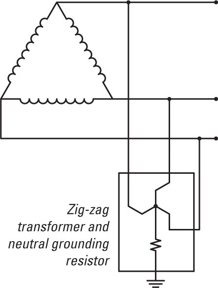

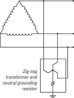

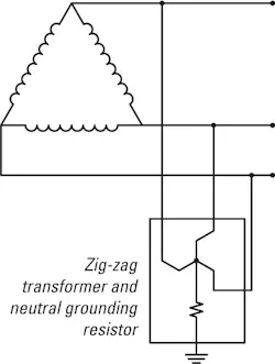

Figure 4. In a delta-connected system a zig-zag transformer is used to create an artificial neutral, which is then connected to ground through the neutral grounding resistor.
How an HRG system works
In an HRG system, the neutral point of the wye transformer connects to ground through a high-value neutral grounding resistor (Figure 3), which normally carries little or no current. An ungrouded system with a delta-connected transformer uses a zig-zag transformer to produce an artificial neutral, which is then connected to ground through the NGR (Figure 4). This transformer carries very little current, so it need not be large or expensive.
