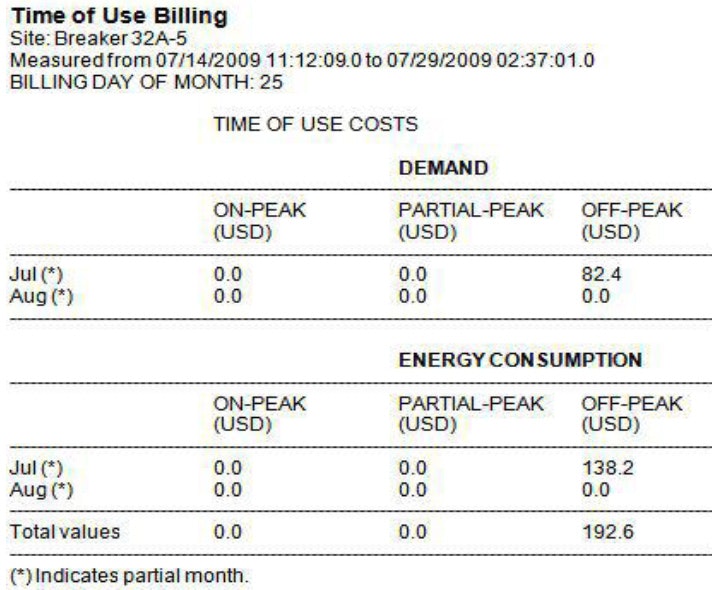

Reports and results
Most energy analyzer software provides printed or electronic reports that summarize and report the result of an energy survey, but the range of capabilities and flexibility vary widely (Figure 2). Reporting requirements vary greatly by application, with some requiring little detail while others might require formal reports on a client’s company letterhead.
Figure 2. Typical energy analyzer software enables printed or electronic reports.
Many applications require advanced PC-based reporting for e-mail or printing. To that end, some instruments enable quick and easy reporting that includes a built-in energy audit report along with the ability to export the information to other software.
