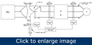

Figure 2. Basic test circuit for verifying GFR fault protection of a VFD when using HRG.
A GFR was tested for use upstream (line side) of a three-phase, 480-V, 20-hp VFD to verify the GFR’s ability to detect a ground fault downstream (load side) of the VFD (GF1 in Figure 2). Additional testing also was performed to evaluate the GFR performance with ground faults of various current levels at other locations in the system (GF2 and GF3).

The test system included a three-phase delta-wye source with the 480-V transformer secondary neutral connected to a 200 Ω neutral-grounding resistor (NGR). The transformer’s three-phase output was connected to the VFD, which was connected through 100 ft of 3C#10 Teck cable to a 0.5-hp three-phase motor.
To configure the VFD for the testing, the various phase-to-ground capacitors, including input filters, were removed or disconnected because they’re not rated for the line-to-line voltage present during a bolted ground fault on a resistance-grounded system. The drive manufacturer’s technical support group was consulted about the best way to accomplish these modifications. This wasn’t a test system issue but is a consideration with any VFD on an HRG system.
