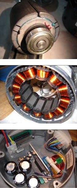

Figure 2. Ultra-high-efficiency permanent-magnet motors feature a permanent magnet rotor (top), a stator and an electronic module (bottom).

Ultra-high efficiency designs such as permanent-magnet and copper-rotor motors remain prospective candidates for utility rebates. Generally, permanent-magnet motors (Figure 2) have higher efficiency than induction motors. At least one manufacturer has plans to develop permanent-magnet synchronous motors for many industrial applications. It’s more likely these offerings would cater to large compressors, commercial refrigeration and air-conditioning equipment. Already, electronically-commutated motors, a type of permanent-magnet motor, (Figure 2) are proposed as drop-in replacements for some single-phase induction motors. It’s expected that utility programs will consider permanent-magnet motors for future rebate programs.
