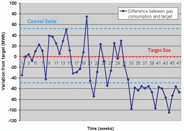

Figure 2. The first step in data analysis is to establish base loads and control limits, so you can know when a rise or reduction in consumption is significant. (Endress + Hauser)
“Collecting information isn’t enough,” says Feasel. “The purpose of a meter is to formally deliver information to a human or system that can do something about it. You have to make the information available to the stakeholders who need to know if it’s good or bad, and how they compare to others.”
A basic approach is analyzing consumption at 15-min. or 30-min. intervals. Understand peak loads that determine power bill demand charges and establish base loads so you can correlate them with production, weather and occupancy. Then you can establish control limits and know when a rise or reduction in consumption is significant (Figure 2).

It’s useful to relate energy consumption to driving factors, for example, heating energy per degree-day, energy per ton of product or electric power for lighting compared to hours of daylight. “These are generally called specific energy consumptions,” Petersen says. “Monitoring them allows you to determine if a certain process is drifting over time — if it is becoming more or less efficient.”
Such a drift might have a number of causes, such as increasing compressed air leaks, heat exchanger fouling or poor steam trap maintenance.
