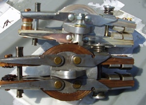

Perry says the event records showed a decrease in C-phase current (IC) and C-phase voltage (VC), while A-phase and B-phase currents increased. “This occurred on two feeders. I suggested testing their transformer, which was a tap changer. When we inspected it, we found that the rotary tap changer contacts were severely worn.
Though it had not completely failed, the old bridge contact (bottom) was about ready to cause a fire, outage and unplanned shutdown.
“What was causing the problem was the C-phase on the utility transformer opening up, leaving the industrial customer in single phase,” he adds. “It wasn’t a complete opening; actually, the moving contacts in the transformer were arcing. That’s why the event report oscillograph showed the collapsed C-phase voltage and the collapsed C-phase current, just as if you were removing the voltage off of the load C-phase. There was a three-phase system within the facility that was actually single phasing, which could cause equipment damage. And of course, the arcing of the transformer damaged the contacts.”
