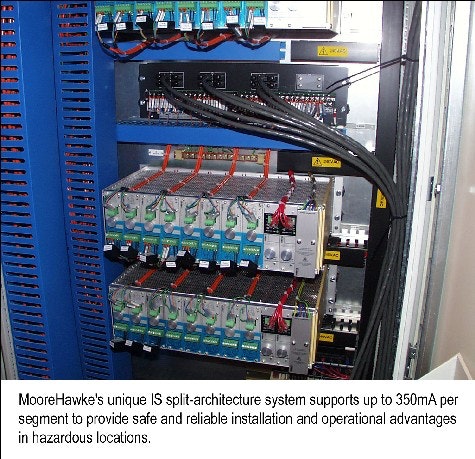

In response, MooreHawke developed a split architecture approach using a field-mounted device coupler, and an associated power supply with a safe-area interface.  Here, the total resistance requirement is obtained via a split resistance; a small resistor is used in the IS interface and a larger resistor is placed in the field device coupler.  The small (trunk) resistor ‘sees’ a large current (sum of all devices), but only generates a small voltage drop.  The larger (spur) resistor ‘sees’ a small current (single device) and so only generates a small voltage drop.
Subsequently approved by the FM (US) and SIRA (ATEX) certifying organizations, this design enables intrinsically safe fieldbus segments to support up to 350mAenough to power 16 devices at 500m while still being intrinsically safe for hydrogen at the individual spur connection.  This allows fieldbus designs to be just as cost-effective and efficient in hazardous locations as it has been in non-hazardous applications.
In terms of reliability, the split-architecture power supply steps around the complexity associated with FISCO circuits by the use of a conventional wire-wound resistor which, in IS terms, is deemed to be infallible.  To further augment the overall systems reliability, the MooreHawke design also incorporates full AC/DC power conversion, simple linear power supply, and full galvanic isolation, with built in redundant supplies.  Here again, fewer components translate into greater reliability.  MTBFs (AKA MTTF) rise.
