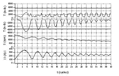

Interruption duration
Figure 2. Shorter interruptions produce larger swings in torque adn current.
Classifying an event as safe to ride through requires minimizing the negative torque spike. Understanding the torque spike requires determining the load’s effect on the motor and the load’s inertia. Also, it’s important to determine when the most severe negative spike occurs and its magnitude. Figure 3 shows the absolute value of the most severe torque spike captured for the tests of the 10-hp motor. The motor load doesn’t change the magnitude of the torque spike, only the interruption interval at which the spike occurs. On the other hand, the load inertia affects both the spike’s timing and severity.
Absolute valve of most severe torque
Figure 3. As motor loading increases, the greatest torque and current spikes occur at shorter interruption intervals.
