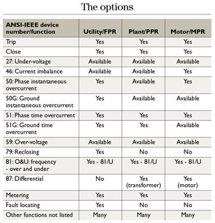

Table 2. Protective relaying functions.

Protective relay functions are identified by a set of standard ANSI/IEEE device numbers. For example, the frequency relay for load shedding is identified by the number "81," which signifies frequency, and "U," which signifies under. Other common numbers include:
27 - Undervoltage.
46 - Current imbalance.
50 - Instantaneous overcurrent.
51 - Time overcurrent.
79 - Reclosing.
81 - Frequency.
87 - Differential.
Letters often provide additional information about the device number. For example, 51G represents a ground-time overcurrent relay.

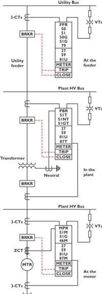

Utility feeder breaker protection is shown in the upper part of Figure 1. Utility feeder protective relays (FPR) typically consist of a number of common relaying and control functions listed in Table 2. The feeder protective relay normally has overcurrent tripping functions; various control functions, such as tripping, closing and reclosing; and fault location. Some utilities include indicating metering, under-frequency load shedding, SCADA and other functions.
Protect three locations
Figure 1. Feeder, plant and motor protection.
Plant breaker protection is shown in the center of Figure 1. The normal line of demarcation between the utility and the plant is at the utility revenue meter. Plant owners are responsible for protection downstream of the metering point. The plant feeder protective relay (PPR) can take on a number of functions, with overcurrent protection as a minimum. However, the plant breaker shown in Figure 1 protects the plant as well as the transformer. In particular, phase and ground overcurrent protection are provided as a minimum. Transformer current differential, under voltage, over-voltage and under-frequency protection are other common protection functions.
Motor breaker protection is an example of a typical plant feeder and is shown in the lower part of Figure 1. The internal plant feeder breakers can protect a number of load types. Consider a motor feeder. The motor protective relay (MPR) can take on a number of functions. In the illustration, it protects the motor from motor and system problems. However, another function not shown is limiting the number of starts per hour.
An optional relay shown in each of the schemes is the 81-U relay, which is the under-frequency relay. When utility systems become unstable and start splitting up, some systems will have an abundance of generation capacity and likely generate an over-frequency condition. Governor controls usually bring the frequency back to normal. Other systems become generation-deficient and the frequency decays. If load is not shed, the system will fail. By proper application of the under-frequency relay to shed load on the utility system, sufficient load can be dropped, generation saved and service restored to the loads in minutes, not hours as occurred in the northeast blackout.
