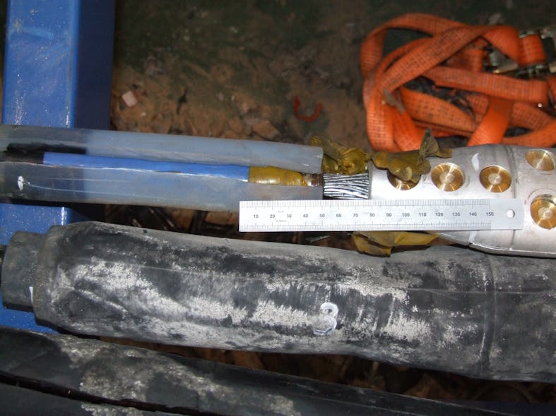

Cable termination procedures are precisely engineered, and any failure to follow them closely can lead to voids, field concentration, and partial discharge. An example of this can be seen in Figure 1, where an overly large gap that was not filled with mastic led to failure.
Furthermore, cable terminations are specifically engineered to ensure that voltage stresses do not exceed the insulation capability at any point. This is accomplished by ensuring that the voltage gradients across the insulation are even (see Figure 2).
When a termination containing multiple layers and different materials is exposed to an electric field, the voltage stresses are larger in the areas of lesser permittivity. Air has a permittivity about 2.3 times lower than insulation, so a void in the termination will have approximately 2.3-times higher field stresses. Combined with a 10-times lower dielectric strength, this leads to discharge across the void.
Voids can be caused by common mistakes in terminations, and Figure 1 also shows how electrical stress is greater in and around the void. Failure to completely fill gaps between the insulation and conductors with mastic is very common. Imprecise trimming of semiconductor layers can leave a void where the stress tube cannot fill the poorly trimmed section. Failing to fully clear the semiconductor layer off the insulation causes a concentration of stress and results in PD even if there is no void.
