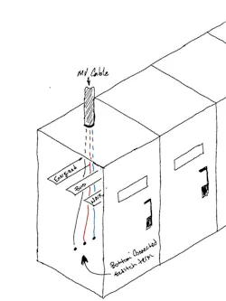

I still remember one of the first medium-voltage cable faults that I cleaned up. It was at a hospital that had recently modified the system to add a new medium-voltage air switch lineup. The installation was in an existing room and required that the conductors enter the switches from the top of the gear. While top-entry gear is nothing new, in this situation, the switchgear as built and delivered to the site was designed to be bottom-fed.
Now, who was to blame for this design issue isn’t relevant to the story, but what happened next was that a well-intentioned electrical contractor found a way around (or should I say through) the switchgear design issue. They decided to route the medium-voltage cables between the switchgear bus to the termination point at the bottom of the switch (see my wonderful sketch in Figure 1).
The problem with this solution is that it places a grounded plane (the cable’s shield) near the energized bus work. To further illustrate the contractor’s misconception, when I asked why he thought it was acceptable to route the cable in this manner, his response was, “Well, isn’t that insulated cable rated for the voltage?” Where was the NETA testing company in this situation, you might be asking.
A couple of things to consider:
  • Technicians commonly show up to test cables and nothing else. If this is the task, their vision of the remainder of the power system might not be in focus. They have a blind spot to other portions of the system.
  • Were the cables routed through the bus before or after the test? If they were routed in that manner at the time of testing, then we could argue that the technician should have caught this glaring issue. Of course, that assumes the technician knows enough about cable construction and that he or she notifies the contractor of the issue and stands firm against energizing the system.
  • Finally, there is the all-too-human factor of “doing the best we can to make it work.” It’s well-intentioned, tragically flawed, and easier than suffering the consequences of stopping the job to find a better solution — at least until the cable causes a switchgear failure.

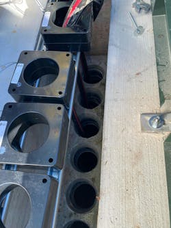

Another equipment design issue that can create challenges in making proper terminations is pad-mounted equipment that limits the distance between the concrete floor and the connection point. This leads to a choice of either working in an uncomfortable, hunched-over body position, or pulling the cable outside the enclosure where additional length (slack) then must be routed and wrapped back into the gear. Routing and wrapping additional cable slack also creates problems with bend radius and with ensuring that the slack remains clear of energized components, as noted in the previous example.
The pad-mounted utility metering cabinet in Figure 2 is an example of a challenging situation I faced in Florida. While there seemed to be plenty of room to make the cables up, it proved very difficult to route the 750 MCM cable to the various termination points from the conduit entries. Had the designer of the installation been aware of this challenge, a trough could have been built/formed under the switch (Figure 3) allowing more movement and easier sweeps of this very stiff cable.

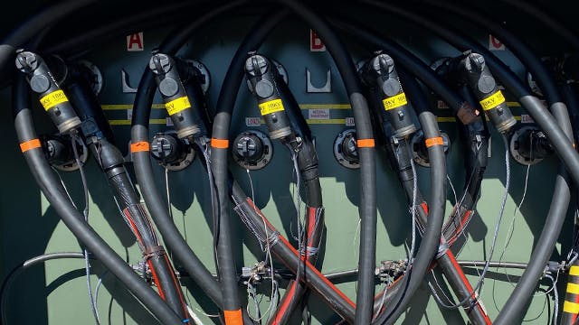

Figure 4 is another example of a poorly designed plan for how cables would be terminated. Note that there is literally zero room to make the Pfisterer terminations required on this piece of gear. I wish I knew how this cable was finally terminated, but I left this project long before the cables were completed.

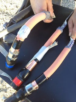

One of the worst installations I’ve even seen was at a chemical plant that was adding additional capacity. Our team was hired by the electrical contractor to test the new cable installations. Our initial test of the cables indicated a termination issue. The issue was sufficiently bad to trip the VLF test set before getting to the withstand voltage. This was followed by an uncomfortable conversation with the contractor that they were going to need to pull new cable to correct the issue.
As with any failed cable test, the first thing to check is the cutbacks of the cable made during the process of installing terminations. Removing terminations costs money and time, and if you are wrong, you can expect to be asked to pay for those losses. In this case, we were not wrong.
Figure 6 clearly shows the poor installation made by an inexperienced and rushed electrician. Note that this photo was taken after surgically removing the terminations to avoid any alteration of what we discovered. The defects were numerous and included:
  • Poor cutbacks
  • Deep cuts into the cable installation at the semi-con cutback
  • Failure to install the constant tension spring, which allowed the braided shield to be pulled out of place toward the cable lug when the core was removed from the stress cone
Admittedly, it is rare to find a cable this poorly constructed, but I assure you that it can and does happen.

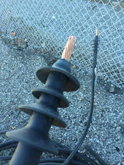

4. Water intrusion in the conductor
Another rare installation issue that technicians need to be aware of involves outdoor terminations, which are typically connected to pole-mounted cutout switches with mechanical lugs. An inexperienced terminator who is not provided with all the proper materials may leave bare conductors exposed for installation into the lug (Figure 7).
On the surface, you may not see an issue with this practice, but consider that this outdoor installation is exposed to rain. Over the course of time, rain will migrate into the cable conductor. The water will build up and create a water column going up the pole, and this water column is capable of building up enough pressure to push loadbreak elbows off their bushings at the pad-mounted equipment that is often located at the other end.
