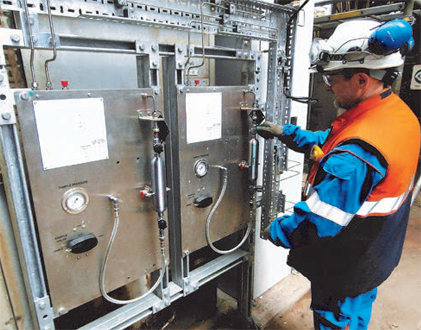

Grab sampling is a process by which a sample is extracted from a fluid system for remote laboratory analysis (see Figure 1). Plant operators use sampling to ensure the fluid meets critical quality standards throughout a facility. Common grab sampling points include near storage containers, on long transport lines, and on process lines at flare locations. In addition, samples may be analyzed before and after a commodity is transferred to determine the value of the cargo, particularly if there is a custody change.
It is especially important to pay close attention to the construction of grab sampling systems when building large-scale facilities. The key to avoiding simple grab sampling system errors is to build them using criteria specific to each facility. Standardized approaches may save time in the short term but may lead to unforeseen problems down the road.
Figure 1. With grab sampling, operators extract a sample from a fluid system and take it away for remote laboratory analysis. Images © 2022 Swagelok Company
