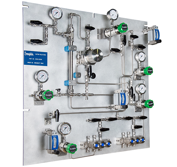

Reliable industrial fluid and instrumentation system performance often depends on designing the system properly and selecting the right components. Depending on your application’s needs, the wrong design choice can lead to poorer performance, potential safety risks, and increased downtime required to resolve issues.
One component in particular can have a major influence on your overall system: Valves. Generally, a valve’s role in an industrial fluid system is to control flow to the operator’s desired levels. Valves are typically selected and incorporated into the system specification during the initial design stage (see Figure 1). Once the system is in service, maintenance technicians will typically replace a valve with the same type already found in the system.
Figure 1. Valves are a necessary component in a wide variety of industrial fluid system operations. Determining the right valve for your application can be accomplished by following the STAMPED method. All images © Swagelok
This makes it critically important that the proper valve – one that will deliver the necessary levels of performance and functionality – is chosen upfront. Total system design must be considered to ensure safe, trouble-free performance. Function, material compatibility, adequate ratings, proper installation, operation, and maintenance are the responsibilities of the system’s designer and user.
One method that can help guide you to the right choice is known as the STAMPED method, which accounts for Size, Temperature, Application, Media, Pressure, Ends (or fittings), and Delivery. By evaluating your system needs according to the STAMPED process, you will have a better understanding of which type of valve will best fulfill those needs during operation.
