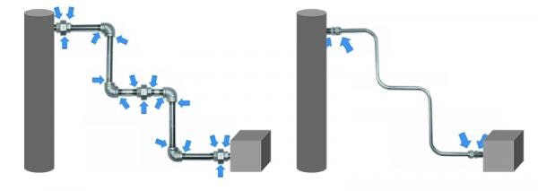

Tube routing and bending. A well-designed system minimizes the number of individual connection points and bends – and therefore the number of potential leak points (see Figure 1). Good design and tube bending also allow for some flexibility during installation, better enabling installers to make high-quality, leak-resistant connections. Reducing the number of individual connection points also helps reduce the amount of maintenance time needed in the future.
Figure 1. Minimizing connection points is a good way to eliminate potential leak points, such as when transitioning from a pipe assembly (left, 17 points) to a tubing run (right, 4 points).

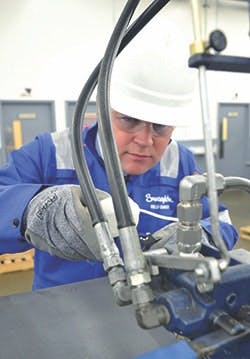

Bubble testing. This is a simple, cost-effective, and common test for installed gas systems, performed either using a thin film surfactant (as shown in Figure 2 on a hydraulic system) or submergence in a water bath. A variety of surfactants are available. Visible bubbles using either of these methods indicate the presence of a leak but do not measure the quantity, which will need to be measured using alternate methods.
Figure 2. Applying a surfactant to connection points on an installed and pressurized system enables technicians to conduct a bubble test to check for leaks.
