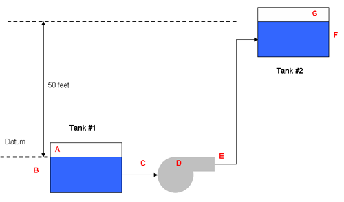

Figure 1. System head curve example.
Refer to Figure 1 as we go through a simple system head calculation. Here we have a pump taking suction from Tank #1 (Pus = 0 psig) and moving to Tank #2 (Pds = 0 psig) that has a liquid level that is 50 feet higher than the level in Tank #1. If we assume that the piping losses total 25 feet at 500 gpm, let’s determine the system head requirements:
Hsystem = (Pds - Pus) + Hstatic + L= (0-0) +50+25=75 feet
Keep in mind that the piping losses here only apply to a flow of 500 gpm. In reality the piping losses are a function of the flow rate, and therefore vary with the flowrate.
