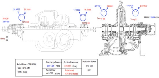

Step3: Use the plant monitoring system, in this case PI ProcessBook, to capture and develop all process tags available in the database giving all information about particular machinery, in our case the BFW pump.
Figure 2. This BFW screen from ProcessBook shows the pump turbine layout and tags.
Figure 2 is a snapshot developed in ProcessBook for the BFW pump that’s being run by a steam turbine. Capture all the important tags that are relevant to a particular piece of equipment — in this case, X,Y vibration readings, suction, discharge pressure, flow, bearing temperature, and speed for the BFW pump. These tags are capturing and presenting real-time process and vibration information as the pump is operating.
