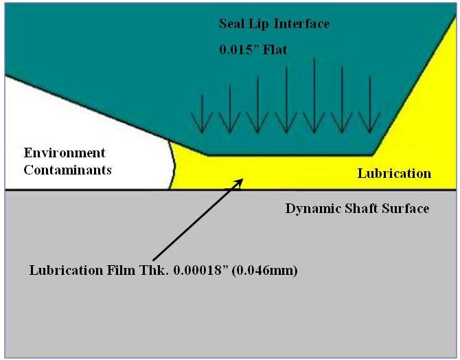

Figure 2. Close-up view of seal lip-to-shaft interface.
Direct contact also causes grooving on the shaft and wear on the lip. Repairing damaged shafts is costly and time-consuming, so most contact lip seal manufacturers recommend ranges for shaft hardness and surface finish. Formation of the oil meniscus is subject to a combination of factors, but mostly radial load, which is the sum of the forces the lip exerts on the shaft (Figure 2).
The greater the load on the lip, the harder it is for the oil to lift it; too little load and the oil will leak past the lip, too much might result in higher power consumption and premature lip wear. Among other factors, radial load is a function of lip material and geometry, the type of spring used, and seal interference. The angle of the lip and location of the spring play a critical role in seal design. Interference is built into the lip design to develop preload on the shaft and provide greater misalignment tolerance. Excessive pre-load, however, can cause shaft grooving and make a seal difficult to install. Harder elastomers such as hydrogenated nitrile butadiene rubber (HNBR) are more abrasion-resistant, but can generate too much lip load thereby causing the seal to generate excessive heat.
