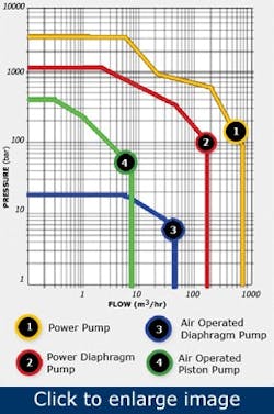

When the system demands are calculated and understood, the pump types that best fit the application can be selected using a range chart (Figure 7). More than one reciprocating pump type often is suitable for an application. It’s then up to the user to assess the unique features and benefits that each technology has to determine what’s appropriate for the application.
Figure 7. When the system demands are calculated and understood, the pump types that best fit the application can be selected using a range chart.
