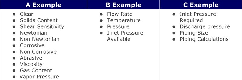

Application analysis
The application analysis stage is a vital step in the selection process. Application of rotary pumps benefits from careful attention to the system’s performance requirements. Application analysis determines initial affordability, flexibility to cover the application’s entire operating range, reliability and energy requirements. It’s important that you understand, identify and communicate your requirements to your pump supplier. The recommended analysis sequence is (a) consider the characteristics of the fluids to be pumped, (b) consider the operating conditions the process requires and (c) determine the system’s hydraulic requirements (Figure 2).
Figure 2. These are the elements of the three-step process for identifying a suitable rotary positive displacement pump.
The ability to self-prime is an important advantage that rotary pumps have over rotodynamic (centrifugal and vertical) pumps. But the design of the pumping elements and the inlet configuration introduce considerable variation in suction capability among rotary pumps. It’s important to remember that the fluid to be pumped is pushed into a pump by the differential pressure available at the pump inlet. Therefore, special attention should be focused on inlet conditions. Users and system designers are advised to ensure the system’s net positive inlet pressure available (NPIPA) exceeds the pump’s net positive inlet pressure required (NPIPR) by a reasonable margin.

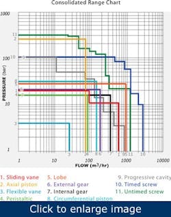

Many rotary pump types are available, which makes the selection of the proper unit for the application seem complex. The selection process involves matching the pump’s capabilities with the fluid properties, operating conditions and system requirements identified in an application analysis. Rotary pump performance capability must be verified over the full range of the required operating conditions. Two useful tools help narrow the choice.
A consolidated range chart (Figure 3) depicts the flow and pressure envelopes of each rotary pump type. Given knowledge of the full range of application flow and pressure requirements, use the range chart to identify suitable rotary pump types. Consultation with the supplier is recommended to confirm specific application recommendations and to investigate special designs, which often are available to provide unique solutions.
Figure 3. The consolidated range chart maps the pump type to the process requirements.
