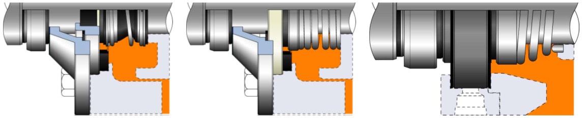

Figure 2 illustrates three of the double-component seal designs used extensively in the food and drink industry. These designs have significant bacteria and microorganism growth potential around the process fluid wetted components. This fundamental problem is caused by the design of the component seal technology selected.
Figure 2 – A range of traditional double-component seal designs are used in hygienic applications.
An alternative is available. Plant engineers don’t need to take risks with these types of designs any longer. Upgraded geometries are now available and make such designs more hygienic. Putting these seals on a par with international best practice guidelines is neither difficult nor expensive.
