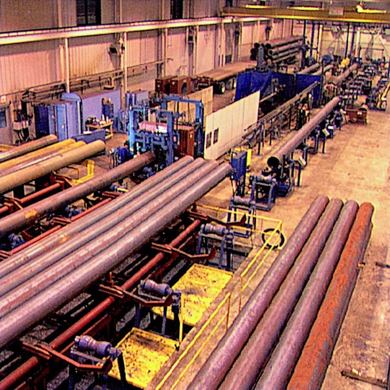

Manufactured by Port Washington, Wisconsin-based Ultra Tech, this pipe is produced under the Ultra 600 brand. Ultra Tech begins with a steel pipe manufactured to a proprietary chemistry, followed by induction heating, and finally water-quenching the inner surface to create a single-wall pipe.
Ultra Tech’s UT 600 delivers the best of both worlds – an induction-hardened pipe with an abrasion-resistant inner surface that tapers to a strong, yet ductile outer surface.
At 600 BHN, the inner surface of this induction-hardened pipe can withstand most common abrasives, and tapers to a 250 BHN outer surface that is ductile enough to accommodate normal handling during shipment, installation and maintenance. With this proprietary process, pipe can be created in various diameters up to 40 inches in varying lengths and wall thickness.
