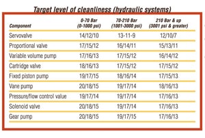

Target Levels of Cleanliness
Target Levels of Cleanliness (TLC) is a three-step approach to filtration and contamination. To use this approach, the system designer must begin by setting desired levels of cleanliness, using the ISO Cleanliness Code 4406. Next, the designer must select filters and elements that achieve these levels. The levels should be absolute beta-rated filter elements. Finally, fluid must be monitored on an ongoing basis to ensure that specified target levels are maintained.
The information listed in Tables 1 and 2 can be used to help establish a TLC. Selection is based on information such as critical component clearance, fluid viscosity and operating pressure.
