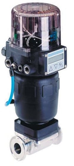

Lightweight and compact, smart valves can deliver decentralized, intelligent process control for Y-pattern, globe, diaphragm and quarter-turn valves.
However, this is changing with the development of single-point, intelligent, programmable I/O. Connected to the valve directly, it allows measurement and control functions to be performed locally and independently. These “smart valve” systems use a compact pneumatic actuator with an integrated electropneumatic positioner mounted on top of the process valve. By using a direct link to the process sensor (flow, temperature, level, pressure, etc.), the smart valve automatically adjusts process variables to maintain setpoint.
As position controllers, they accept analog or digital signal inputs to establish the valve set position. In this mode, an integrated position controller compares the actual valve position reading against the setpoint. The valve position is measured by an integrated potentiometer. Adjustments are then made by activating internal pilot valves.
As process controllers, the position control loop works as a secondary service control loop. The process controller in the main control loop has a PID (proportional, integral, derivative) algorithmic function.
In this case, the setpoint is compared against  the actual process variable sensor signal and the valve position is adjusted accordingly. The actual value is determined by a sensor signal (frequency, Pt 100 or 4-20 mA representing the process measured variable). The setpoint may be established internally at the valve using an integrated keypad, or externally via a standard analog or digital input signal.
