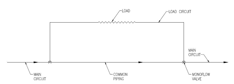

“When two piping circuits are interconnected, flow in one causes flow in the other, to a degree depending upon the pressure drop (resistance to flow) in the piping common to both.” (1)
This premise is illustrated by the mono-flow circuit shown in Figure 2. The valves provide a fixed resistance (pressure drop) in the main circuit, which induces flow into the load circuit. This equalizes the pressure drop between the two valves, regardless of whether the water flows through the load circuit or the common piping.
Figure 2. In the mono-flow circuit, the valve position induces flow in the load circuit. (Click to enlarge)
