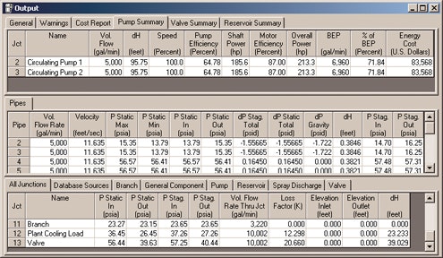

The text-based results are shown in PSIM’s output window (Figure 3). The output window is arranged in three sections; the general section at the top includes summary reports for pumps, valves and reservoirs and the cost report. The middle section is the pipe output and, at the bottom, is the junction output section.
Figure 3. The software performs many calculations that support system optimization.
This example illustrates only a fraction of the fully configurable PSIM output data that can be presented in either English or SI units. In addition to text, PSIM includes two graphical outputs. The visual report displays selected input or output data with the model diagram. The graph results provide graphing capabilities for a range of system variables, such as the pump versus system curve (Figure 4).
Figure 4. The software can output system curves.
The pump summary report provides key information related to system efficiency. Overall power for each pump, that is, power into the motors as a function of pump and motor efficiency, is 213.3 HP each.
Energy consumption for one year is $83,569 for each of two pumps. While these pumps have a 76% peak efficiency (according to the manufacturer’s data), we can see they’re operating at only 65% efficiency. The reason is shown in the "% of BEP" column, which indicates the pumps are operating at only 72% of the best efficiency point (BEP) flow. These pumps are oversized. The valve at the pump discharge must be throttled to achieve the design flow rate. The last line in the output window says the valve throttling imposes a loss of 39 feet of head. System efficiency takes a hit from two directions - the pumps’ lower operating efficiency and the head loss across the throttling valve. Matching the pumps to the system requirements will address both of these issues.
