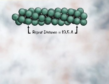

Some maintenance engineers believe joint sealants won't stand up to use because of the inherent composition of PTFE. The chemical structure of PTFE is a fully fluorinated backbone carbon chain. PTFE's strong atomic bonds give the sealant its characteristic chemical resistance. Unfortunately, other properties are sacrificed to provide these gains. Without chemical cross-linking or electrochemical attraction to itself, PTFE does exhibit a flow characteristic, especially when subjected to high stress and extreme temperatures. Figure 2 illustrates PTFE's molecular structure.
Figure 2: PTFE's molecular structure
