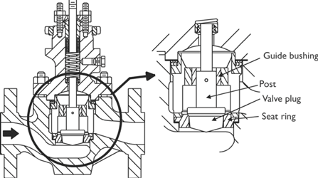

The first distinction among globe and angle valves is whether the valve is post- or cage-guided. In post-guided valves (see Figure 2), the closure member is guided by a bushing surrounding either the valve stem or a portion of the valve plug. In cage-guided valves (see Figure 3), a close-fitting, cylindrical cage guides the plug. Cage guiding provides a comparatively larger guiding surface, which helps minimize vibrations, improve valve plug stability and increase pressure drop ratings.
Figure 2. Post-guided valve.
