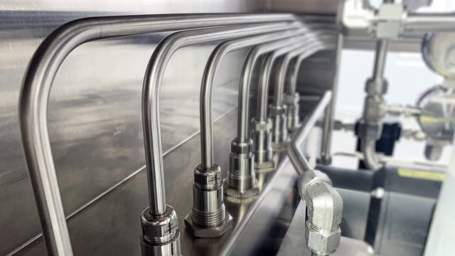

Tubing systems are complex environments that require an understanding of the specific tubing being used before installing a tube fitting connection. For example, tubing comes in a variety of interior diameters, wall thicknesses, surface finishes, and concentricity. This variety, while increasing its useability, makes the decision of which one to use complex.
Be sure to examine an application closely before deciding which type of tubing to employ (Figure 1). For example, leaks often occur because tube fittings are under tightened when installed. Skilled technicians often pull up tube fittings based on instinct and feel which, while important, may not be the most effective way. The variables involved in tubing affect how much force is necessary to pull up a tube, and just one change to the variables (such as size, wall thickness, or hardness) can have a significant impact on how the fitting feels to the installer.
