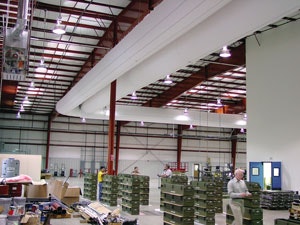

A fabric ductwork system helped a metal fabricating plant save $500,000 in construction costs.
 The HVAC system uses eight 23,000-cfm evaporative coolers by Champion Cooler Corp. of Little Rock, Arkansas. The units are paired together with a plenum that runs through the exterior wall and splits into a "Y" shape that supplies each pair of duct runs. Each pair, which spans from 180 ft. to 300 ft., in length, has factory-engineered linear mesh vents installed lengthwise at 6, 7 and 8 o'clock, and at 4, 5, and 6 o'clock.
The main production floor's HVAC design uses strategically placed ceiling and wall fans to eliminate collected hot air at the roof level and exhaust enough air to produce a positive building pressure. Ceiling exhausts are thermostatically controlled to remove heat, while wall fans have sheet metal duct drops 18 in. off the floor to eliminate air stratification and pull air from the 20-ft. high fabric duct. According to Roger Bakel, the original design called for roof-mounted exhaust fans which, when combined with the weight of sheet metal duct system, might have surpassed the ceiling's load-bearing specifications.
