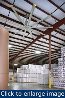

WOW also replaced hundreds of ineffective and expensive floor fans with 43 Powerfoil fans from Big Ass Fans. “We talked to another company and tested their product,” explains Wally. “They installed a fan. At the end of the day, the Big Ass Fans folks had the best value and were able to show us on paper and through references that they were the best choice.”
Fans circulate large volumes of air, maintaining uniform temperatures throughout the WOW Logistics facility. Within the cool room, the fans reduce the load on the cooling system while providing increased product integrity.
The installation of Big Ass Fans resulted in an initial annual saving of $134,000. “This is an average savings of 59% on the heating bills compared to 2006, before the ceiling fans were installed,” says Wally. “If you look at the buildings, most of our facilities have a peak or sloped roof, so we have 30 ft. to 40 ft. of clear span or space inside. The temperature differential will be 15° to 20° from floor to ceiling. We need to maintain 45° to 50° throughout the building. Destratification pushes the air down and circulates it. We would have 2° between the floor and the ceiling.”

Any new WOW facilities will have the new lights and new fans, explains Wally. From a technical perspective, Big Ass Fans operate on a simple physical principal: unlike small, high velocity fans that produce small, turbulent air streams, which dissipate quickly, a 24-ft diameter Big Ass Fans uses a small, 2-hp motor with 10 patented airfoils with winglets designed to move a vast amount of air slowly. The air current from the fan approaches floor level in a cylindrical column of a size equivalent to the fan’s diameter and then turns into a horizontal flow that radiates out in all directions. The horizontal air flow continues until it reaches walls or airflow from another fan, at which time the airflow turns upward and back toward the fan. This produces convection-like air currents that gather inertia as the fan continues to spin and moves the air down and out.
