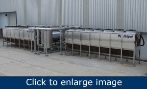

Schaefer explored alternatives, and their search led to Ecodry, a closed-loop process cooling system from Frigel North America. The advantages quickly became clear – less water and energy consumption, lower costs and cleaner water.
With the Ecodry, the water returning from a process is pumped through heat exchangers and cooled with ambient air, providing clean water at the right temperature to process machines year round.
Ecodry systems provide customers with substantial water, sewage and electrical savings due to the patented adiabatic cooling chamber and free cooling capability in some operations. Source: Frigel North America
The Ecodry maintains water below that setpoint through its patented adiabatic cooling process. Ambient air that’s too warm passes through the adiabatic chamber, where it’s automatically pre-cooled using a small mist of water. Otherwise, the system runs completely dry.
There’s virtually no evaporation in the closed-loop system, so in addition to dramatically reducing water consumption, the technology runs free of the contaminants that often produce scale in traditional cooling systems.
As an additional efficiency benefit, the system also offers free cooling when ambient conditions and setpoint allow the chillers to be shut down. The Ecodry system has been in use around the world for more than a decade and at manufacturers across the U.S. for more than five years.
