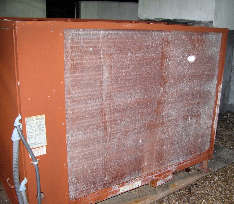

Aside from fruit-processing plants, most coastal area HVAC equipment is bombarded with corrosion caused by ocean salt (Figure 2).
Types of coil corrosion
Figure 2. This corroded coil is from a coastal area.
