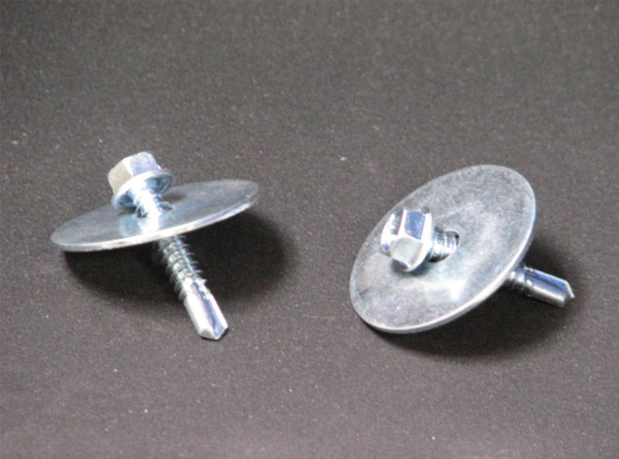

Figure 2. Off-the-shelf hardware, such as self-drilling screws and fender washers, are commonly used with a steel mounting angle to secure the top portion of some stationary walls to a facility’s ceiling joists.
Tack-weld or clamp a mounting angle to the ceiling joist bottom flanges along where the flexible wall is to be installed. Attach the top of the wall curtain to the mounting angle using self-drilling screws and fender washers spaced approximately 15 inches apart (Figure 2).
